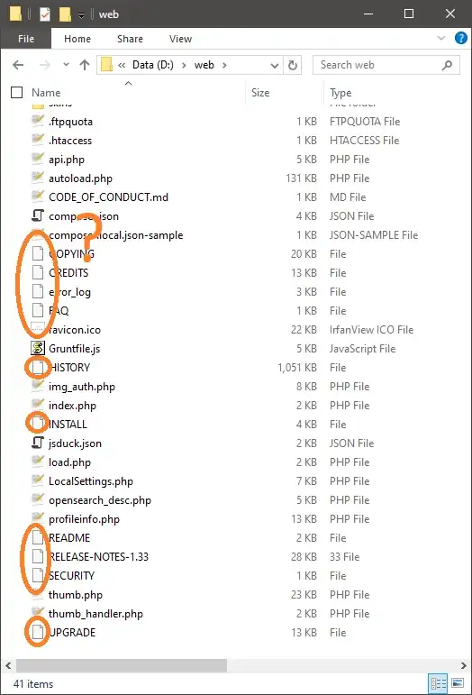

Why do developers choose to not use file extensions for certain files? Here is an example from MediaWiki -
This appears with intention, e.g 'CREDITS' and 'COPYING' is with legal intent, perhaps. Why do they do this? In what cases should I do this?

There's no established mandate in the Linux world that there must be extensions. Filesystems for UNIX-like operating systems do not separate the extension metadata from the rest of the file name. The dot character is just another character in the main filename. Instead, internal file metadata is popularly encoded within the beginning of the file to show what kind of app opens it.
If a file has no extension, and it is not executable, it's likely plaintext, especially if all uppercase.
As K7AAY says, there is no strong connection between the filename and the filetype, although I disagree that files with no extension is likely to be plain text. The way to find out with some degree of certainty is to use the file command:

90% of the filenames circled are all uppercase letters. This is addressed in our sister-site Software Engineering:
All-uppercase letters stand out and make the file easily visible which makes sense because it is probably the first thing a new user would want to look at. (Or, at least, should have looked at…) As others have already said, file names starting with a capital letter will be listed before lower-case names in ASCIIbetical sorting (LC_COLLATE=C) which helps make the file visible at a first glance.
The README file is part of a bunch of files a user of a free software package would normally expect to find. Others are INSTALL (instructions for building and installing the software), AUTHORS (list of contributors), COPYING (license text), HACKING (how to get started for contributing, maybe including a TODO list of starting points), NEWS (recent changes) or ChangeLog (mostly redundant with version control systems).
This is what the GNU Coding Standards have to say about the README file.
