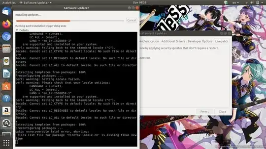

When I try to install updates, I get the error messages shown here:
screenshot of Software Updater
The last messages are:
dpkg: unrecoverable fatal error: aborting:
 files list file for package 'firefox-locale-en' is missing final newline
One day when I was using the PC, Firefox suddenly disappeared. When I searched for it I found that it was deleted. I downloaded it again from Ubuntu software and I got it back. But when I clicked on Show Applications I noticed that there were two applications named firefox, one with the icon and another without it. I ignored this but since then when I try to install software via the Terminal or try to update, I get the message the file for package firefox-locale-en is missing final new line.

dpkg: unrecoverable fatal error, aborting:
E: Sub-process /usr/bin/dpkg returned an error code (2)

Run the following commands to fix the problem:
sudo rm /var/lib/dpkg/info/firefox-locale-en.list
sudo apt install --reinstall firefox-locale-en
You should get a warning:
dpkg: warning: files list file for package 'firefox-locale-en' missing; assuming package has no files currently installed
Ignore the warning and run the following commands to update:
sudo apt update
sudo apt upgrade
Please post any additional errors. Thanks.
