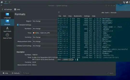

In this system, open System Settings > Regional Settings, and click on the Formats icon in the left panel. In the image below, I chose a time format setting for Malta from the dropdown next to Time, logged out and logged in again. On opening konsole, I see this
Time format setting for Malta

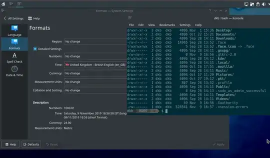

To change to something else, I just go through the process again, log out and log back in:
Time format setting for UK
One point to note is that just because you see something in the dropdown (in System Settings > Regional Settings) and can apparently choose it, that doesn't mean it's actually available.
