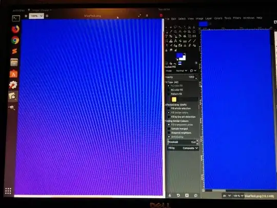

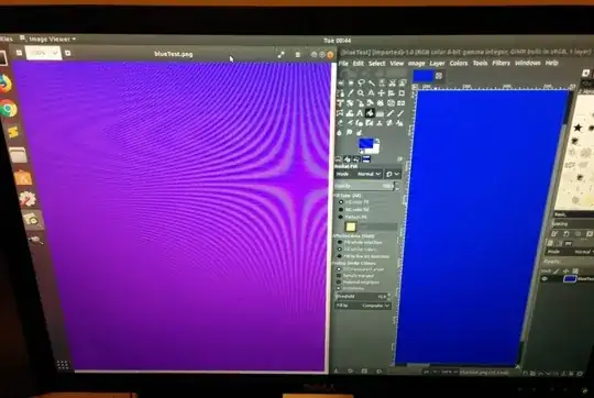

Here are some photos. It is hard to capture with a camera, but the Image Viewer (left) renders the blue test image distinctly purple, whereas GIMP (right) does not.
Also interesting is that the GIMP render remains the same shade of blue regardless of the viewing angle. Whereas the Image Viewer's shade of purple changes with the viewing angle. Looking down at the screen from the top, it is a distinct purple. Whereas looking up at the screen from the bottom, the purple almost looks like the blue it is supposed to be.
The moire pattern observed in the Image Viewer is not visible to the eye. However, maybe it is related to the color change depending on viewing angle effect...
Top view: top angle
Bottom view: bottom angle
Jet Blue

Turning off color management seems to have resolved the issue. The setting can be found at:
Settings → DevicesDevice Colour Profiles
A restart is required to see the changes.
