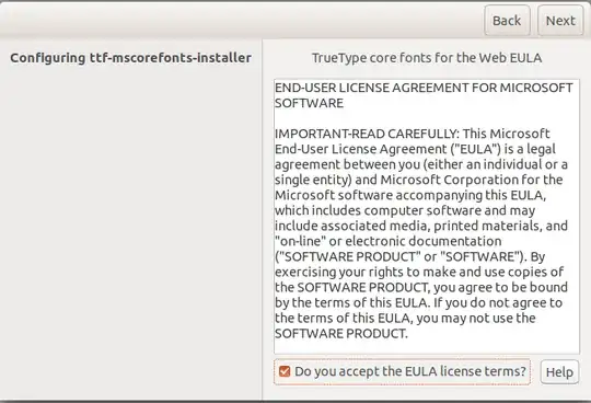

After launching the installation of ttf-mscorefonts-installer, I am asked for acceptance of the EULA license
Configuring ttf-mscorefonts-installer

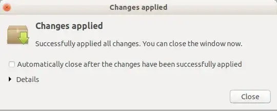

The following message makes me think that all is fine:
Changes applied

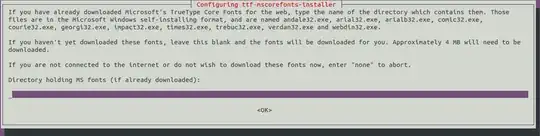

Launching the above command, first I get this window about font files location:
I leave the line blank since the fonts have presumably not been downloaded (not extracted, not found).

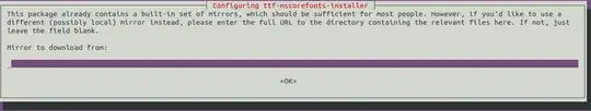

Second, this other window on mirror repository
where I again leave the line blank trusting that the system is informed about where to fetch the material.
