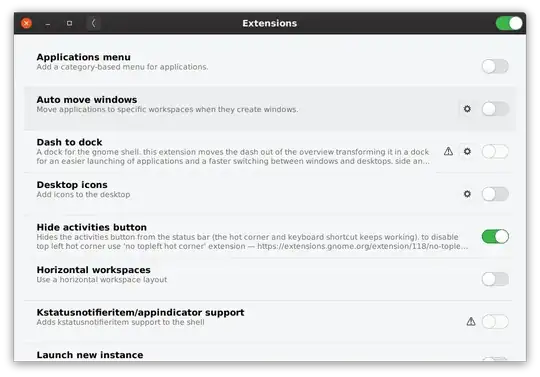

I found in Tweaks in the top right, there's a switch that was turned off. Turning this on activated all my extensions.
