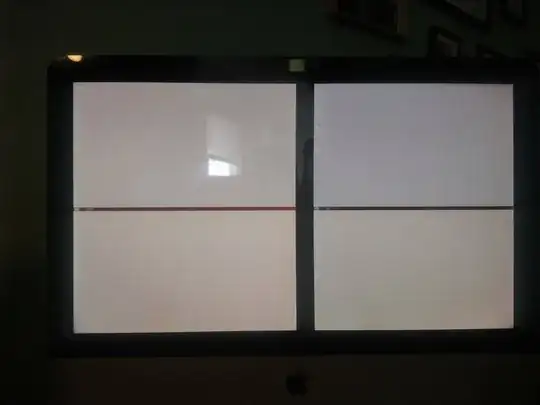

I would like to install Ubuntu 18.04 on my iMac 21.5-inch late 2009 with the following specifications:
  • CPU: 3,06 GHZ Intel Core 2 Duo
  • RAM: 8 GB 1067 MHz DDR3
  • GPU: ATI Radeon HD 4670 256 MB
For the installation process I am using a bootable USB-Stick.
Whenever I try to boot my screen splits up into 4 smaller screens which makes it hard to see anything on the screen and then I have to manually shut the iMac down.
How can I make Ubuntu 18.04 run on my old iMac?
splitscreen after booting Ubuntu from usb

Hello I found the solution just if you hold CMD + v at the start of Macintosh you will be in the verbose mode 20 there you will be able to add the nomodeset instruction in the grub
