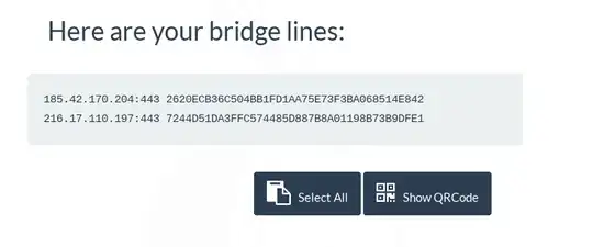

then you should get the bridge line. for get the bridge line go to https://bridges.torproject.org/ and get your bridge line. getting bridge lines for configure tor bridge

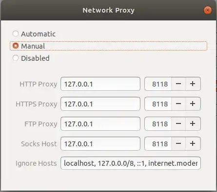

or if you use the desktop version of ubuntu you can set the proxy in Network configuration like the image below.
Network proxy in desktop version of Ubuntu
