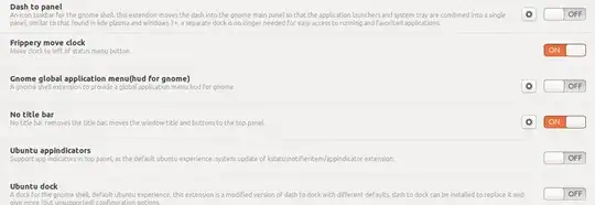

As a background: I tried to twist the panel view, in order to save space (one panel) and get programme's context menus (File, View ...). Maybe this has to do with my issues, so here are the extensions that I installed:
I disabled the "Gnome global application menu" extension when the following behaviour fist appeared, but it hasn't changed since:

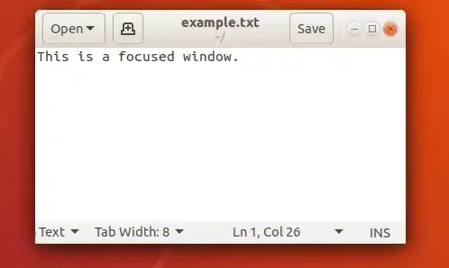

  1. When I press the Alt button, e.g. for Alt+F4 to close a window, the window loses focus and hence the shortcut doesn't work. Alt-Shortcuts that are not bound to a window (e.g. Alt+F2 for command prompt or Alt+TAB) work. Here is how the window behaves, when I press Alt+F4:
