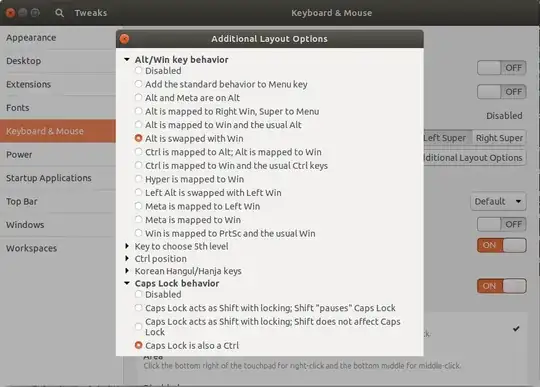

[UPDATE] The changes I made are in Keyboard & Mouse > Additional Layout Options > Alt/Win key behavior and Caps Lock behavior shown in the screenshot.
screenshot of options I chosen

The gsettings get org.gnome.desktop.input-sources xkb-options command outputs:
['altwin:swap_alt_win', 'caps:ctrl_modifier']
