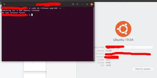

entered the command for updating to 19.10 from 19.04
As you can see in the image above, I tried to update to 19.10 and it says that
No new release found
I checked the /etc/update-manager/release-upgrades to see if the Prompt is LTS but it is still normal.
What would be your advice?
UPDATE: I already updated the system to 19.10. Thank you very much for the advices.

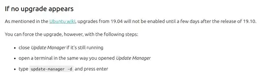

It will appear one week after the release. Until then it still is considered a "development" release. You can get it anyways when specifying -d:
do-release-upgrade -d

Looks like you need to wait a few days, or force the update with the -d flag
