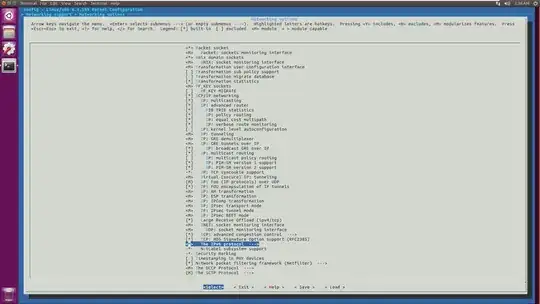

To make completely disabling ipv4 entirely impossible. After a quick check on make menuconfig on kernel 4.4.189. I could not find a way of disabling ipv4 without disabling the entire TCP/IP stack. enter image description here
