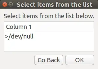

Relabel Zenity Cancel button
You can relabel the button but you can't remove it:
$ zenity --list --cancel-label="Go Back" --column="Column 1"
Will give you:

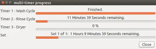

Yad Progress bars
You can define multiple progress bars in yad where zenity only offers 1. You can also include scrolling text.

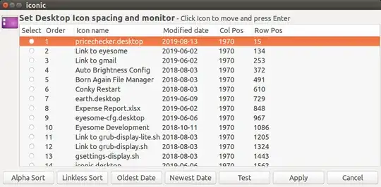

Yad buttons
You can assign any text you want to any button. Also notice you can include a Window icon too.

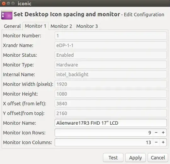

Yad text entry
Yad displays text for you to change. Zenity cannot display existing text you can only enter new text.
