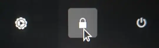

  1. Click the lock symbol: enter image description here

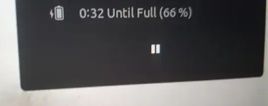

  3. So I have to move the mouse again to end the black screen then press the pause button enter image description here
As I took the picture I had 66% again, but it was at 55%, so I have lost 45% of energy in only ONE night in standby! So whats the trick here? Is there a feature to keep the energy in standby mode for 1-2 weeks or is this not possible with Ubuntu?
