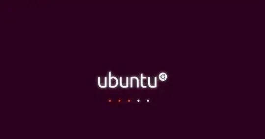

When i boot my PC in quiet splash mode after the purple screen I get a black screen for some second and then this splash screen,
Splash screen
But after less then a second the splash screen disappear leaving back just a black screen for the rest of the boot.

The part responsible for the splash screen is called Plymouth. As reported by Wiki.ArchLinux:
Plymouth is a project from Fedora and now listed among the freedesktop.org's official resources providing a flicker-free graphical boot process. It relies on kernel mode setting (KMS) to set the native resolution of the display as early as possible, then provides an eye-candy splash screen leading all the way up to the login manager.
According to this if there is some problem with the splash screen Plymouth is the responsible.

Then reboot your system and the splash screen will appear but with this theme:

This solved my problem and now the splash screen appear after just 6 seconds from the BIOS screen and don't disappear until the end of the boot
