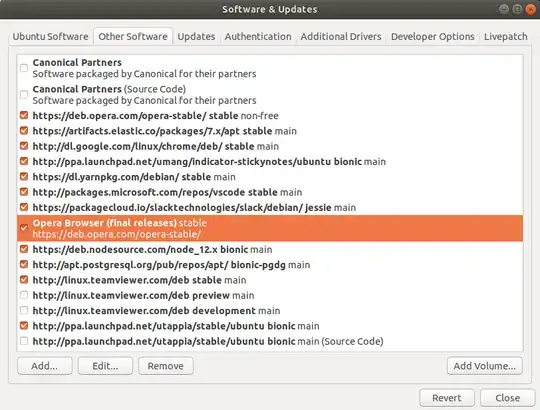

Solution 2
  1. Open the Software and Updates application
  2. Click on the Other Software tab
  3. Scroll down and click on Opera Browser (final releases) stable
  4. Click the Remove button at the bottom
  5. After the removal, click the Refresh button to update your cache
Screenshot of the solution
That's all.
