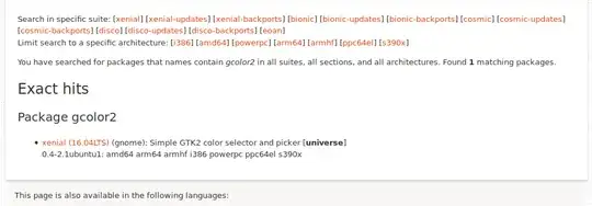

As the image below shows, it is absent from the regular Bionic repositories:
gcolor2 is only listed as being in xenial
Image sourced from here.
