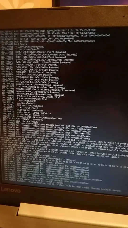

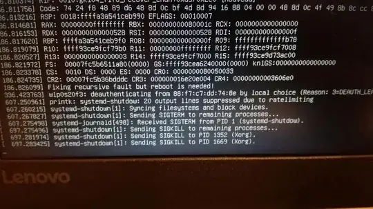

Also from time to time when i shutdown the computer it shows this: enter image description here enter image description here

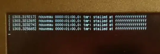

And always when i shutdown the laptop it shows this: enter image description here
