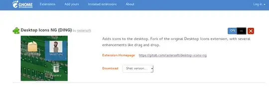

Finally I've found an answer to this! It'e extremely annoying and I don't understand why this question seems to be so uncommon (I didn't find anyone asking this, lt alone commenting on this!).
The problem is with the Desktop Icons Extension. It does provide icons in the desktop, but in a weird way that its most annoying.
The solution? UNINSTALL IT FIRST and then install Desktop Icons NG (DING) by rastersoft.
That did solved my issue.
