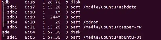

lsblk
and got this result: lsblk result on terminal

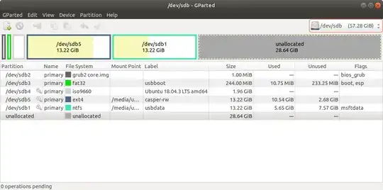

Forth, I loaded the GParted utility and here is the snapshot: GParted snapshot
Now back to my original question: How do I proceed in order to increase the casper-rw and usbdata partitions using the free/unallocated space without losing any data?

After the cloning you can edit the partitions with gparted. If you touch only the casper-rw partition and the usbdata partition (amd if an MSDOS partition table the extended partition), booting will not be affected.
Edit: How to edit the partitions to fill the drive.
  • Be sure you have a backup (for example the original drive).
  • Read how to use gparted.
  • Boot from another drive
  • Unmount all partitions on the target drive
  • Start gparted and check that there are no lock symbols on /dev/sdb1 and /dev/sdb5.
  • Move /dev/sdb1 to the tail end (to the right)
  • Drag its left border of /dev/sdb1 to the left until the size is what you want
  • Drag the right border of /dev/sdb5` to the right to use all remaining unallocated drive space. The two partitions should 'touch each other'.
  • Check that things are as you want them.
  • Click on the tick icon to start the actions.
  • Please wait ... it will take a long time. Be sure there is enough power (do not run on battery).

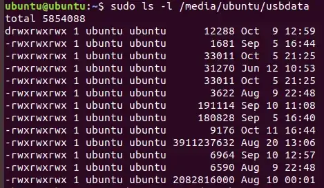

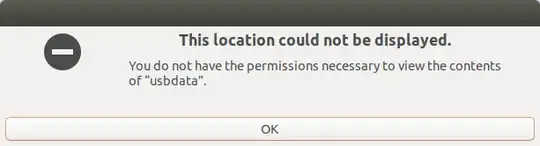

After cloning with mkusb, copying partitions from the original USB stick and booting from the new-larger stick, I'm unable to access the usbdata.
Access to usbdata partition blocked
Please advice. Thanks!
Advice: Please post the output of the following command lines (when booted from the new-larger stick),
sudo lsblk -f
sudo lsblk -m
sudo ls -l /mountpoint-to-usbdata
sudo ls -l /mountpoint-to-casper-rw
where you enter the actual mountpoints to see usbdata and casper-rw.
This will help me understand what is the problem, so that I can suggest what to do next.
Please edit your original question to enter these output texts instead of here in my answer. Indent each line 4 characters in order to render the output as code. You can mark (high-light) the text and click on the {} icon at the head of the editing window to make those indentations quickly.

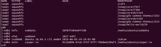

Outputs of the four above-mentioned commands:
The command sudo lsblk -f gives the following results

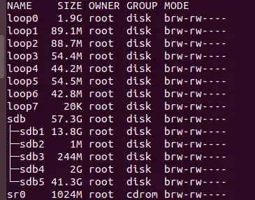

The other one (sudo lsblk -m) outputs the following info:
sudo lsblk -m results

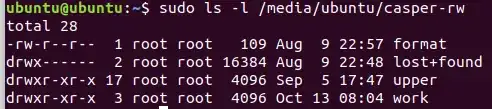

The last two commands and results:
result1

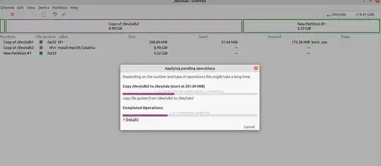

Eliah Kagan
  • 119,640
Just open ubuntu and install gparted, umount all partitions that you want to clone. Select partition from usb A in Gparted and copy >> paste to another usb B.enter image description here
