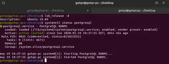

Open the terminal and paste:
sudo apt install postgresql-12
Then check the status:
sudo systemctl status postgresql
