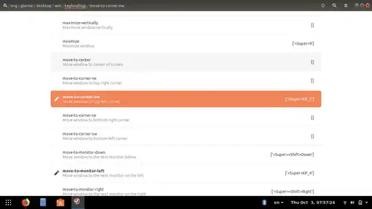

There are built-in-functions with wm keybindings..
to see what are those functions either use gsettings command or use dconf-editor tool (to install dconf-editor run sudo apt install dconf-editor)

you can use this syntax ['<Super>KP_4'] to assign the shortcut Super+KP_4
gsettings set org.gnome.desktop.wm.keybindings move-to-side-w "['<Super>KP_4']"
Or use the simple GUI way with dconf-editor
