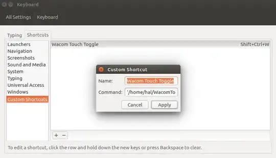

  1. Set up a keyboard shortcut
If you want to run this without the terminal, you need to save the script in a file, make it executable and create a keyboard shortcut for it. That's because you can't assign a command directly to the tablet's buttons (but you can assign a keystroke ...).
In Unity open System Settings > Keyboard > Shortcuts and create a new shortcut. Avoid the Super key since it may not always work in step 3.
As command, put the name of your script file (full path, between single quotes, if you're not sure then drag-drop the file in a terminal and use the created command).
  1. Assign the shortcut's Keystroke to your button
Open System Settings > Wacom Tablet > Map Buttons ... and assign the keystroke you chose to your button.
