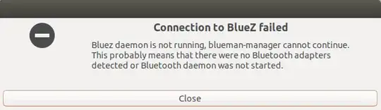

Bluetooth in Ubuntu on a dual boot Acer Aspire E5-521 laptop fails with this message: enter image description here

But still I got the same error message at the beginning of this question. So I decide to try to use my Bluetooth trough the terminal. At the very first I found the following command:
sudo service bluetooth start
And that almost solve my problem; now I can use my Bluetooth properly in Ubuntu. But still remains a little issue: I need to run the above command every time I restart the computer in order to get working the Bluetooth.

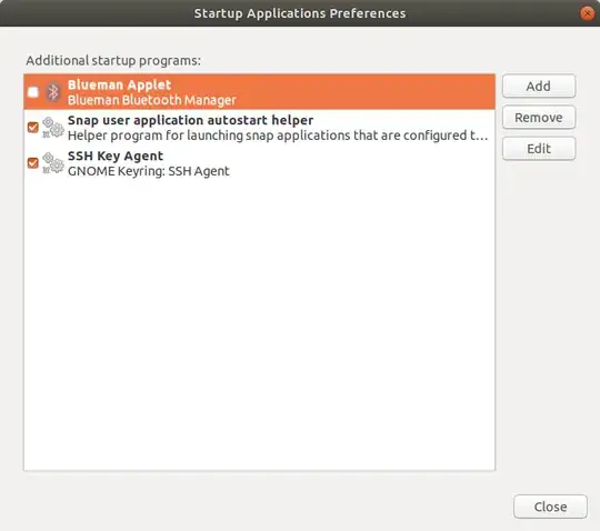

I run the command: sudo systemctl enable bluetooth That prevents that I have to run: sudo service bluetooth start every time I restart. But now the Bluetooth is always turned on! ( as expected I think) So I had kind of the opposite situation where I have to turn off the Bluetooth every time the Ubuntu starts to save battery energy when I do not need it. Thus I went to Startup Applications Preferences and uncheck the Bluetooth: enter image description here
And that's it! That completely and finally fix my Bluetooth in Ubuntu.
