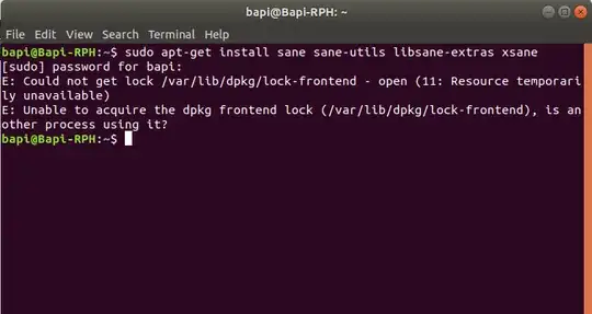

But while running this command in the terminal, it gives some errors and installation is not done.
The error message is shown in the picture.
Can anyone tell me how to solve it. enter image description here
Bapi Saha
  • 469
Try restarting your PC.
If the error persists then execute the command
sudo rm /var/lib/dpkg/lock*
Then try again.
What happens is that when ypu try installing a package/packages the package manager acquires the a lock on the database so that another instance of the package manager does not simultaneously perform operations.
Sometimes this process gets interrupted and the lock does not get released so you have to do it manually.
