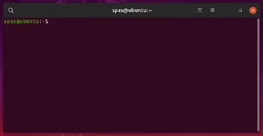

Add indicator to the shell's prompt: Based on the @waltinator's idea, in order to have a counter in the front of the prompt for several different shells when the level is deeper than one, I've added the lines, shown below the demo, at the bottom of the relevant run commands (~/.*rc) files.
I've made tests on WSL, Ubuntu 16.04, Ubuntu 18.04 (server/desktop), Ubuntu 19.04, within gnome-terminal, tty and ssh session. Here is how this works:
The limitation is that: the counter works only for 13-14 levels of depth, depending on the OS. I do not intend to investigate the reasons :)
