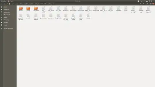

I looked up at what this amdgpu-pro-fans script does, and found that it essentially accesses the card's directory (/sys/class/drm/card0/device/hwmon/hwmon2) and gets the value from the file pwm1_max (which is 255), calculates the percentage of the input, and writes this new value down in pwm1. I have no idea why this value is 255 or what it represents. There is also a fan1_enable file, which contains a value of 1, and a fan1_input file, which cannot be opened, because it is of "unknown type". This is probably related to the issue in sensors. Also, the file temp1_crit shows 104000000, while temp1_crit_hyst shows -273150. I am pretty sure these values are garbage. They can also be seen in the sensor output above.
hwmon2 is the only folder in hwmon. I see some people have hwmon3, but I don't know why. Here is a screenshot of the hwmon2 folder:
