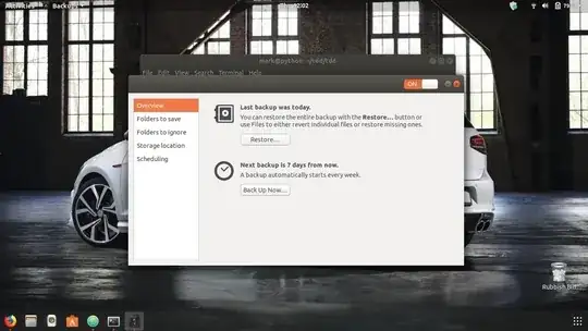

Screenshot showing backup appI now use an external 2 TB HDD to store backups in case of a system crash. If Ubuntu fails to boot for any reason, how do I use the external HDD to recover the system to its full glory with all the docs, pictures, music, videos, and other files?
Do I need to boot it from the boot menu for recovery?

Since you now use the default Déjà Dup app, you would need to reinstall Ubuntu, reattach the external HDD, then launch Déjà Dup and restore from within it.
Déjà Dup is a GUI for Duplicity. The encrypted tar files which Déjà Dup makes to back up the /home directory contents can be manually opened, and specific files extracted to selectively restore specific files and directories at any time.
The earlier answer is much more comprehensive, and discusses why to choose what to use and how to use it. Learning what's out there and making an informed decision about how to protect your data is extremely useful. I would not be happy with just one backup in an drive stored in the same place as the computer, as that's won't protect against file, flood, quake, or theft.
