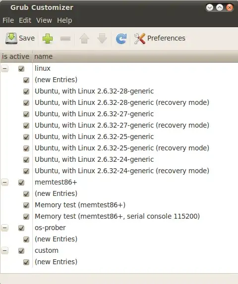

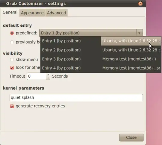

install grub optimizer
sudo add-apt-repository ppa:danielrichter2007/grub-customizer
sudo apt-get update
sudo apt-get install grub-customizer
Grub Customizer will now show up in the Applications > System Tools menu.
Or you can open it from the command line.
gksudo grub-customizer
image inside for grub options

MAKING THE GRUB2 BOOT MENU AUTOMATICALLY VISIBLE
For some reason, editing the GRUB_GFXMODE=640x480 settings in the Grub Customizer usually makes the boot menu visible:
  1. Install grub-customizer as above and update
  2. find Grub Customizer in the GUI (for me it's in System>Administration>..., but for some it is fund under Applications>System Tools>..)
  3. Open Grub Customizer and select Preferences> Advanced
  4. Select GRUB_gfxmode (640X480) - if it is already selected, deselect it, reboot, and select it again.
  5. cross your fingers and reboot!
I have no idea why this worked for me, but it worked on both of my computers, so hopefully it will work for you too!
