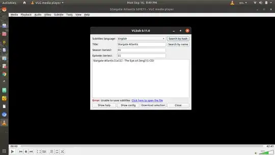

I use Ubuntu 18.04 with VLC 3.0.7. Since some time ago, I am not able to automatically download subtitles through VLC. I have to use the Click here to open the file option in the error dialogue and download them using Firefox. The subtitles were supposed to be automatically downloaded to the folder in which the video file is located.
I tried setting folder permissions using chmod as 777 and 755. Both failed. Any help will be great.
VLC subtitle window

It appears the cache subfolder is missing. For Ubuntu Linux just open terminal and run mkdir ~/.cache/vlc

Some had to delete an existing vlc folder in the ~/.cache directory, recreate it with mkdir and then restart vlc.
Case you are using the snap, mkdir ~/snap/vlc/common/.cache/vlc .
