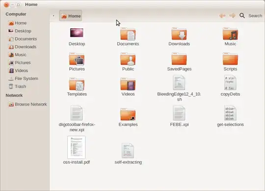

Open nautilus to see the magic !
image of nautilus in Ubuntu 12.04

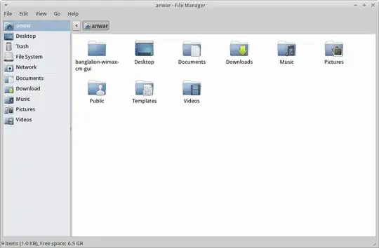

This image is from thunar in Xubuntu 12.04 LTS.
thunar file manager in Xubuntu 12.04
