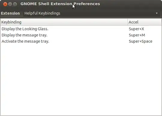

A GNOME extension has been developed to enable keyboard access to messaging tray.
You can, by default, use Super + M to display the messaging tray and Super + Space to activate the messaging tray. You can also configure the keyboard shortcut to your wish.
