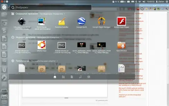

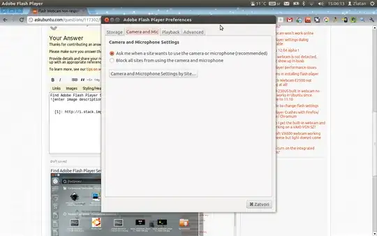

Find Adobe Flash Player Settings app. Configure it (see photo 2). enter image description hereenter image description here For Google+:

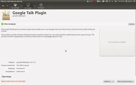

Are you installed GTalk plug-in? You need it for Google Talk video chat. If you are not installed it, install it from Ubuntu Software Centre. enter image description here
