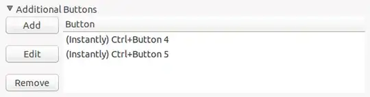

This is possible using instant gestures in Easystroke Gesture Recognition. Define the following buttons in Preferences ▸ Behavior ▸ Additional Buttons:
Additional Buttons

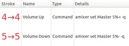

and the following actions in the Actions tab:
Actions
The commands I've shown change the volume without displaying a notification. Watch this question for better alternatives.
