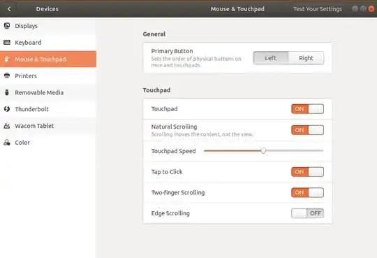

please check the mouse setting
In the Mouse Properties window, select the Wheel tab and try adjusting the number of lines to scroll the mouse or try changing the mouse to scroll one page at a time. After this is adjusted, click Apply and then click OK. Verify this change helps correct your mouse issues.
Please check Instruction in the given image
