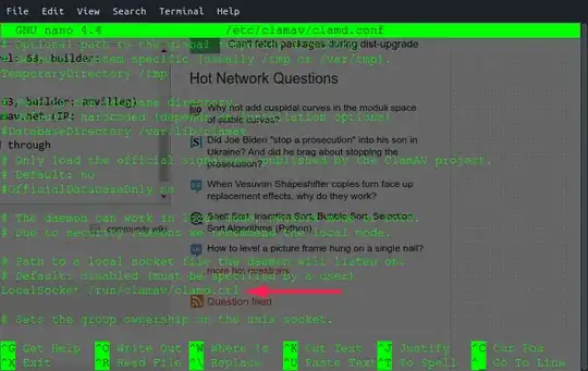

Add a sock file for ClamAV:
sudo touch /var/lib/clamav/clamd.sock
sudo chown clamav:clamav /var/lib/clamav/clamd.sock
Then, edit /etc/clamav/clamd.conf - uncomment this line:
LocalSocket /var/lib/clamav/clamd.sock
Save the file and restart clamav-daemon.service
