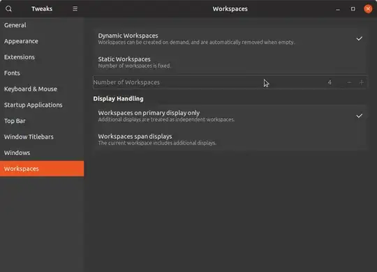

By default, Ubuntu 19 has dynamic workspaces, meaning it will create more as you need them, however if you want them to be static, you can install the Gnome Tweaks from Ubuntu Software or by:
sudo apt-get install gnome-tweaks
Then just head to workspaces and set them to the number of static desktops you want. Gnome Tweaks - Workspaces
Hope it did help.
