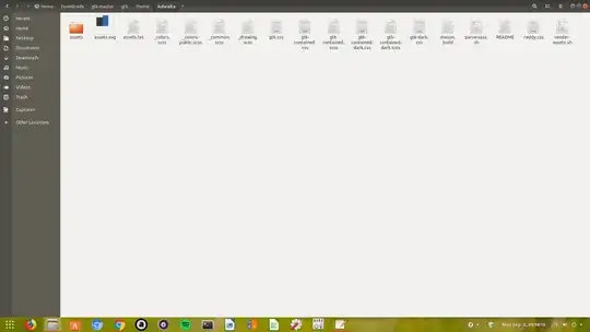

I Just tried it by understanding the README file from ~/Downloads/gtk-master/gtk/theme/Adwaita/ from the link you provided.. https://gitlab.gnome.org/GNOME/gtk/tree/master/gtk/theme/Adwaita
  1. Have downloaded the source code zip file..

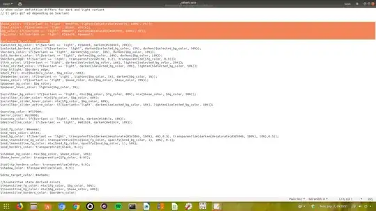

  1. edited some colors (just to try) in the file ~/Downloads/gtk-master/gtk/theme/Adwaita/_colors.scss
Content:
$base_color: if($variant == 'light', #00FF00, lighten(desaturate(#241f31, 100%), 2%));
$text_color: if($variant == 'light', black, white);
$bg_color: if($variant == 'light', #0000FF, darken(desaturate(#3d3846, 100%), 4%));
$fg_color: if($variant == 'light', #2e3436, #eeeeec);
$selected_fg_color: #FF0000;
  1. Saved & Closed

  3. cd ~/Downloads/gtk-master/gtk/theme/Adwaita
  4. sassc -M -t compact gtk-contained.scss MyCustomized.css

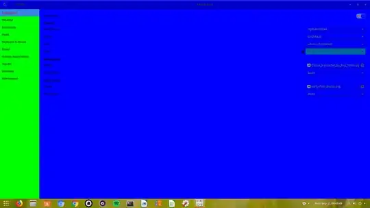

  5. copied this MyCustomized.css file into a newly created theme folder in /usr/share/themes/MyCustomized/gtk-3.0/ and renamed it as gtk.css
  6. copied the assets folder from ~/Downloads/gtk-master/gtk/theme/Adwaita/ to /usr/share/themes/MyCustomized/gtk-3.0/
  7. this MyCustomized theme can be selected from gnome-tweaks
and the result is
