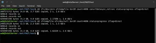

It seems that the kernel itself might be ok but somewhere in the benchmark tool (Disks) of ubuntu could be the issue.
Solution (work-around): I created a directory in the disk to be tested and then terminal into the directory and ran two commands on it. The first commands creates a temp file (4GB in size) and tests the write speed of the disk and the second command reads that file and tests the read speed.
The commands: -write: dd if=/dev/zero of=tempfile bs=1M count=4096 conv=fdatasync,notrunc status=progress oflag=direct -read: dd if=tempfile of=/dev/null bs=1M count=4096 status=progress iflag=direct
Here is my result: terminal command results
