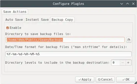

Geany 1.32 comes with a customizable plugin to automatically save a timestamped backup to a destination of the user's choice. For example, a timestamped backup of ~/.bashrc looks like this:
/home/dkb/Public/GeanyBackups/.bashrc.2019-08-28-16-25-51
Geany allows timestamped backups
