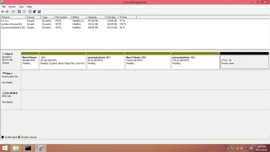

I tried to install ubuntu 19.04 in my friend laptop. His laptop is lenovo g580 with 4gb ram. I have created a free disk partition of 280gb.photo from windows disk management

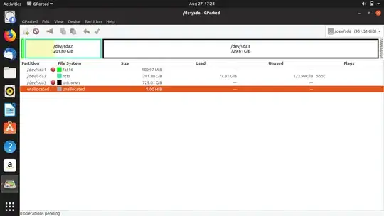

But when i try to install ubuntu in his laptop i get to see no partition available for installing. So i got to check the gparted which shows as From gparted
I dont know what to do now. I have serched for the internet where i cannot find a reasonable solution. So what should i do ?

PLAN A:
Back up everything he has then verify it. Twice. You don't want to lose his data.
Collect his Windows 10 recovery / installation media and all media required to reinstall his apps. Also collect his installation keys.
Convert the Dynamic Disk to Basic Disks.
Then you can install Ubuntu.
