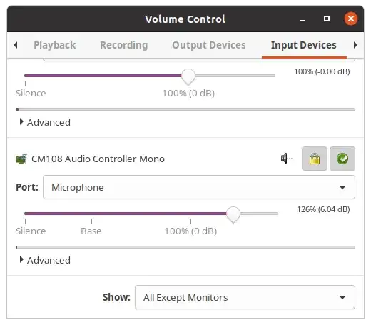

        Install pavucontrol:
sudo apt install pavucontrol
Launch it by running pavucontrol on the command-line, and adjust the volume of the mic in the "Input Devices" tab. You can even go above 100%, although I don't recommend it as it can lead to distorted sound:
