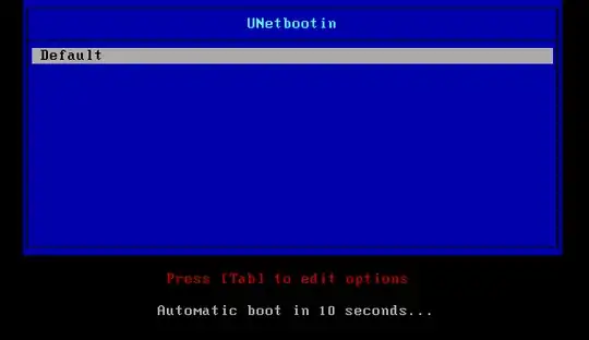

I need to create a Windows installation USB drive from an ISO file. I used UNetbootin which seems to be the only tool that can write non-Linux images.
The USB disk boots (sort of), but it gets stuck at the very first stage. A UNetbootin splash screen appears that keeps counting down from 10 to 0, and then restarts.
The screen looks like this:
Is there a way to make Windows boot from a USB image created on Linux?

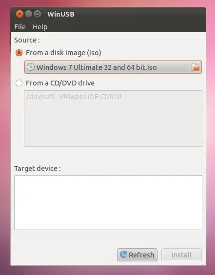

To create your bootable installer disc, select an ISO image or CD/DVD disc, and click Install enter image description here
This will create your Windows Vista/7 installer USB. It is worth mentioning here that the tool might also work with Windows 8; however, it has not been tested. Having said that, the developer has mentioned that the supported images include, “Windows Vista, Seven+.” You can install WinUSB either from the Deb package given at the developer’s website (for Oneiric, Natty, Maverick and Lucid), or from the PPA given below.
sudo add-apt-repository ppa:colingille/freshlight
sudo apt-get update
sudo apt-get install winusb
Since WinUSB also works from the command line, you can create a Windows 7 or Windows Vista USB installer by following the command line format given below
sudo winusb --format <iso path> <device>
Once the USB is formatted using the above method, install a Windows partition and edit the Master Boot Record:
sudo winusb --install <iso path> <partition>
