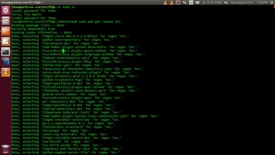

sudo apt-get remove tor.
I run the above command yes with . and it showed me do you want to uninstall tor and its components of 973mb and i clicked yes then half way down i realized tor cant be worth that amount so I pressed ctrl+z, and now i cannot see Google Chrome App Store and some other apps.
How can I fix it?
following output of the command which i pressed .
