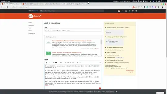

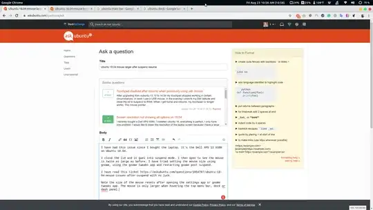

Note the size of the cursor resets after opening the settings app or gnome tweaks app. The mouse is only larger when hovering the top menu bar, dock or dash panel.
Large cursor. Click to see large cursor image.
Small cursor after opening settings app. Click to see small cursor image.
