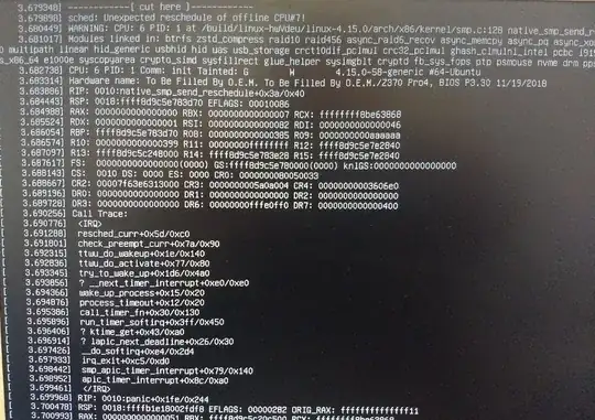

And after reboot I get a message that makes no sense to me: "Unexpected reschedule of offline CPU#7" (see photo).
Note that when I move usr.old back to usr (and remove binding in fstab) then everything works fine.
Ubuntu panic: Unexpected reschedule of offline CPU#7

I had same situation about Ubuntu 20.04 LTS does not boot because I had changed the /usr directory but it was from SDD to HDD instead your situation, I got the same problem while boot it though.
My scenario was moving /usr from / to other partition, such as /home partition in HDD. Unfortunately, many forums that I had searched about "how to move your directory" did not solve my problem: most of their methods give partition mount fail or kernel fatal error.
The one or two of good answers was in this question and this question but as I said they did not solve to me.
Symbolic link does not work in Boot, it will fail if the directory is symbolic.
Possible Explanation
I don't have a precise answer as to why this happens, but I do have some deductions that make the OS not turn on:
  • It is "Status Quo". You can not boot without /usr. Booting without /usr is Broken and LinuxQuestion
  • /usr contains the majority of user utilities and applications but it has some folders that are important to "follow" the booting, such as /usr/sbin and /usr/lib. If you move /usr it will occur error in kernel...
  • The initrd might be one of the reasons that cause errors, and maybe it should be changed too or not. Comment in this question
I'm open to better explanations and corrections, but that's what I was able to deduce after many days of testing and solving this problem.
