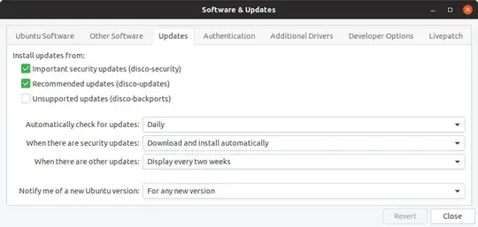

You are duplicating the work being done by Unattended Upgrades, so encountering interference is expected behavior.
Take a look at the Software & Updates control panel, the 'Updates' tab:
Look at the line: When there are security updates
Those security updates are downloaded-and-installed-automatically using apt...just like updates that you initiate. Security updates can occur at any time, but often occur just after startup.
Since only one apt session can run at a time, one of you gets locked out with an error message until the current apt session completes. That lockout is the classic error message you encountered. Another process was indeed using apt at the time.
If you want to verify, look at /var/log/apt/history.log. You will likely see two sessions, one that installed the security updates, and another (yours) that installed the rest.
Interfering with Unattended Upgrades causes no damage. The same packages get installed regardless of who initiates the upgrade or when.
