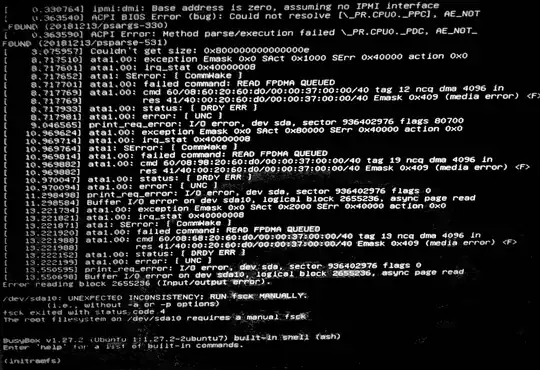

I have Ubuntu 19.04 dual booted alongside Windows 10. I had not used my PC for a month. The last time I used my PC, Ubuntu was working great. Today (after a month), when I turned on my PC, the boot process got stuck on a black screen with some text written on it. I don't understand what is written (too much technical terms). And at last line "intramfs" is written and I can type and enter any command into it (just like in the terminal).

we can find the solution in this part of the error:
/dev/sda10: UNEXPECTED INCONSISTENCY: RUN fsck MANUALLY.
        (i.e., without -a or -p options)
fsck exited with status code 4
The root filesystem on /dev/sda10 requires a manual fsck
Busybox v1.227.2 (Ubuntu 1:1.27.2-2ubuntu7) built in shell (ash)
Enter 'help' for a list of built-in commands.
(initramfs) _

Run the following command to try to fix the error:
sudo fsck -fy /dev/sda10
