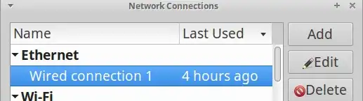

Double click on the network connection (in my case the little symbol of wireless on top-right)
Choose > Edit connection... and select the connection you want to edit (in my case the Wire Connection 1):

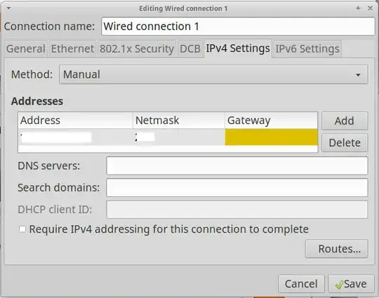

From the window that will be open, select the tab IPv4:

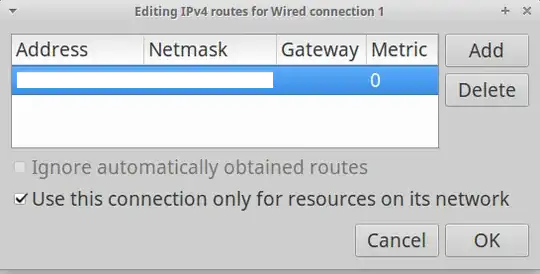

Organize the network as you prefer (in my case no DHCP but a P2P connection with a little embedded system and a switch in the middle). Now press Routes on the bottom-right side and select the option Use this connection only for resource on this network:
Press Ok and Save the setup.
The wifi for internet and the ethernet for the P2P are working perfectly at the same time. Thanks @user68186

  1. open Edit connection...
  2. create (or open the existing) Wire connection
