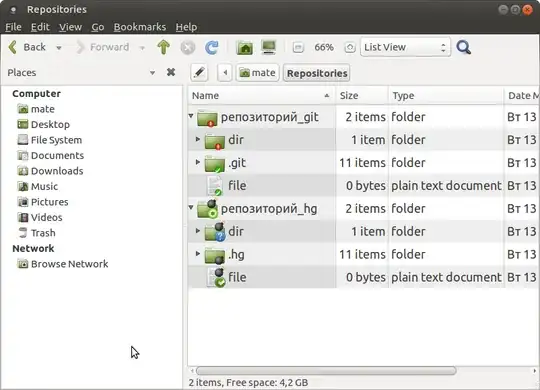

But I see that there is a problem with RabbitVCS on displaying emblems for Cyrillic objects inside Mercurial repositories. For such objects RabbitVCS shows extra error emblem
/usr/share/icons/hicolor/scalable/emblems/emblem-rabbitvcs-error.svg
on all Mercurial items as follows:
Caja with Git and Mercurial repositories - errors on Cyrillic names
I do not want to rename all 25 Mercurial repositories to ascii latin names. So I need to disable Mercurial in RabbitVCS and use TortoiseHG for such .hg repositories. As I know that TortoiseHG allows cyrillic file-names.
How can I do this?

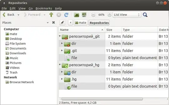

We need to patch RabbitVCS files to remove all mentions of Mercurial.
For anyone interested there is a special PPA with patched packages.
To install them on Ubuntu 16.04 LTS or Ubuntu 18.04 LTS use:
sudo add-apt-repository ppa:nrbrtx/rabbitvcs-nohg
sudo apt-get update
sudo apt-get install rabbitvcs-core=0.16-1nohg~ppa1 rabbitvcs-cli=0.16-1nohg~ppa1
With these packages the error emblems will be removed:
Caja after patch
and we can use both tools for repositories -
  • RabbitVCS menus for Git (and really for SVN with Bazaar);
  • TortoiseHG for Mercurial (even with Cyrillic names).
